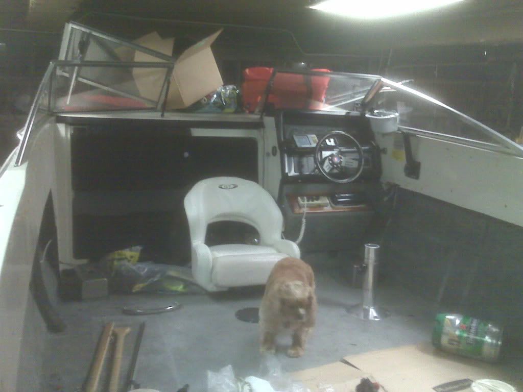

The only thing left I really think would be worthwhile to do with my boat (aside from maybe the helm - different topic) would be to somehow create an enclosure. Since I'm on the sound, there's been PLENTY of times when it's a nice night to be out, but spray and cool wind make it uncomfortable for my passengers. Not to mention, having an enclosure would make it feel a bit more cozy and protected, which is ideal.
My problem is, I'm not sure how easy it would be because my boat's a cuddy with a fairly low profile windshield, which angles back sharply. In fact, it looks very similar to the one in the photo below (bimini and all!). It seems like the front glass would have to be really high, and come off the windshield at a sharp angle, which might even make snaps impossible.
My bimini has built in zippers for an enclosure, so I presume having one made would be doable (no time or materials to try it myself) in that sense. Just curious what you guys think. Are there any other options to consider? What I'd really like to do is throw a hardtop on there, but that's getting very pricey, and I just can't keep sinking money into the old girl...
43191
A picture of my actual boat from last winter to give you an idea of the windshield angle (this is after I gutted to redo the interior - came out awesome!)

Thanks, although I think what you're suggesting is above and beyond what I really need.
My boat is generally a fair-weather boat. It's just not big or comfy enough to be out on in even light-medium chop, let alone foul weather. In other words, I don't intend to use the enclosure frequently per se, I'd just like to have one stowed away for those nights when it'd come in handy. So I guess part of the deal is it'd have to be fairly easy to remove and install.
Therefore, I don't feel the need to get the heavy duty glass, or the thread, or anything else fancy. Most importantly, I'd like a nice, tight fit that's not a pain to deal with, and that LOOKS good too!
