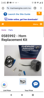

So I finally got the weather to check the buzzer.
So the buzzer has two spade connectors, one for the positive and one that is from the temp and the VRO. It also has a ground pigtail.
So when I turn on the key, the buzzer sounds. Good 12v positive to the spade connector. When I disconnect the ground pigtail and ground it to a ground sorce. The buzzer alarms, but when I ground the spade connector from the temp, VRO sensors. The buzzer does not sound. So before I order another buzzer, is that indicative of a faulty buzzer?
Thank you, Jeff

Not that I remember....are you talking about the horn? Buzzer?
Should work or not I believe.
Does yours look like this?
That is close.
It's the one attached, it had two spade connectors on the back. One is 12v positive and the other spade connector is where the brown wire from the temp sensors plug in. The pigtail is a ground.
When I ground the brown wire, I get no alarm.
But when I ground the pigtail, it alarms.
Jeff

When I bench test a horn it only works one way. Must be a diod. Wire from the sensor is the ground.
The horn part that I listed is the correct horn for your motor.
Thank you @saltchuckmatt.
I wasn't sure if there was a separate circuit inside the horn or not because it works from one side but not the other.
The warning horn I posted is what I have. BRP part number 585994. I did order one last night.
It has two spade connectors on the back and the ground pigtail with the barrel connector.
