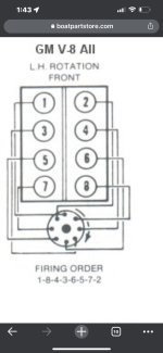

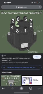

Good morning I’m reaching out to anybody with knowledge on an issue I’m having. I have a 1984 Bayliner 2850 I believe it is an a Q260 with a engine GM350 SBC VA. I bought the boat a few months ago it was running rough I changed the alternator and the starter ran better couldn’t get the idle correct so I recently purchased for plug wires spark plugs distributor cap distributor rotor. Asked a friend to give me a hand who claimed to be a mechanic now my distributor doesn’t look like it’s in the same position I’m not sure where number one is on the distributor cap I’ve looked at several images online several videos online several tutorials a lot of people have different ways of doing things which is understandable but the way I did it I followed the majority of people that were doing it in one particular way. They used to run rough now it doesn’t run at all. I definitely need some serious advice and or help . The distributor cap before things were moved around was in 180° different rotation that is now the advance was facing the rear of the boat as well as the window since I had been taking advice off of YouTube and other information it said that the advance needed to be facing towards the front of the engine as well as the window and that number one on the cab was directly over the window on the port side and then I have followed the firing order from there I honestly believe that I have the distributor and or distributor cabin wires backwards. Any help would be great. So tell me if I’m wrong. Look at the pictures below, the picture of the Is the same cap that I have so position one is above the window and the window should be facing the front of the engine(bow of boat). When I first got this boat, This was facing the back of the engine (stern). This is where I follow the fair in order for the wires. I do not remember the firing order it was originally in when the window was facing the back of the engine. I did remove the distributor and before they reinstalled it they put the engine at the number one compression stroke but the only thing I forgot to do was mark the position of my rotor.

I can do the work. What do you suggest? As of now I’m at a loss. I’ve worked on engines before but for some reason I just can’t figure this out. I’ve done compression testing on all 8 cylinders and compression has passed. #1 is at top dead center, returned distributor back with the rotor pointing at the #1 cylinder/spark plug location. Followed clockwise attaching wires in firing order 18436572. Plugs, wires, rotor, cap, & ignition coil are all new. As I attempt to turn it over I get backfire from the carburetor. So I don’t know what else to try.
