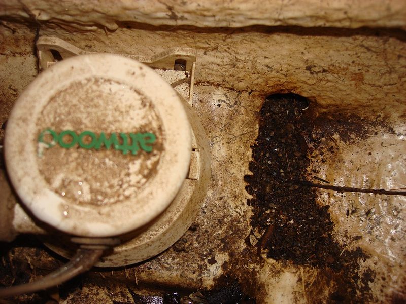

Hi everyone,
I bought this boat few weeks ago,it's a 1990 Bayliner capri 1800 open bow. 2nd time taking it out and have noticed some water coming out of the drain hole after each time of use. I don't recall of any water splashing in and do not see any deep gouges underneath the hull. I also took a picture from inside at back where the fuel tank is located and looks to me like the floor is rotten at "where the drain plug is located". Any suggestions where the water might be coming in? How hard would it be to fix the rotten area? I checked the strength of it and it is not soft it is very hard underneath especially.

Thanx for your help everyone. I have posted some pictures of the problem. The transom is very sturdy and hard there are no major cracks at the transom. Please check out the photos and maybe we can come to a conclusion on this!

Anyone? Please help I have posted pictures I need to know what is the right approach about this? As you can see the transom looks very good. The only issue is where the drain plug is. Any help will be greatly appreciated.

Hmmmm, YOU say the transom looks very good, based on your pictures, I say the transom looks very bad. We have a dilema. It appears from your pictures that your transom has some rot going on around the drain tube. The black area looks like molded fiberglass and that is not good. Take a 3/8 inch drill bit and drill some 3/4 inch deep holes into the transom at various places in and see if you get light brown, dry shavings or dark brown wet shavings. I'm betting on the latter. If it is the latter you are going to have to replace the transom. There are plenty of threads on the forum to help guide you through the replacement process.

Your picture here:
http://www.gts1.00show.com/images/1990-3.jpg
is what a rotted transom looks like :(
Darn it! I guess I did not get a good deal afterall:mad:. Does anyone know how to remove the top fiberglass portion that sits over the fuel tank in the back? Or am i going to have to crawl inside that little opening where the fuel tank is? I never worked with fiberglass before and I do not know if I am capable of repairing that on my own? Could I maybe do a patch repair? Does anyone have the transom replacement for 1990 Bayliner step by step with pictures? I will keep taking pictures steb by step to keep everyone posted of my project and maybe you guys could help me and guide me through the process? Thanx for all your help guys.

The update is: Pictures will follow. I have siliconed all the areas around the holes at transom where water escapes where the outboard engine is. Around the mount fittings of the engine. I also siliconed the trim on the side all the way around the boat. I siliconed the surrounding of the drain plug in the back. My question is where the cables come out in the back there is a rubber boot approximately 3" long but water can easily get in there i looked from inside and nothing is sealed from inside where the cables are coming out? Any suggestions with that one? Time to take a long screw driver and unscrew the drain plug and start poking the rotten fiberglass:eek: hopefully my boat does not fall apart.

If you can poke a screwdriver into the transom you need to replace it.

I actually will replace the transom with new fiberglass I just sealed from outside the areas as seen in the pictures on my website since I really want to find out where the water is coming in. Check out new pictures! www.gts1.00show.com

Actually you do not replace the transom with fiberglass. The transom is wood under the fiberglass. You have to split the boat in half and remove the wood, and glass in new wood. If you have a rotten transom, you need th check the stringers too.
