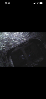

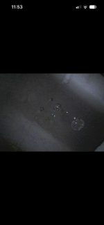

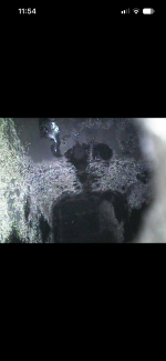

I see some light scuffing on the cyl wall in the 1st pic, definitely a valve seal leak in one cyl, also the motor was rebuilt at some point because I see a piston stamped .030”.

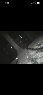

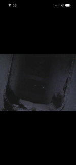

Looks like some very light corrosion in one of the pix as well. Nothing too bad though….
53,265

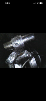

Holy detonation pock marks batman.
Agree with Lou. Someone has been in the motor before
Yeah I bought the boat with roughly 100 hours on a rebuild. I’ve since put another 100 on it. To me it didn’t look like water had been running though it too much if any. A week before I initially pulled the risers I did leave the boat in salt water for a week. Which I normally don’t do. I would think if salt had been laying around I would have seen more traces of rust
Lou C
Nov 10, 2002
14,519
