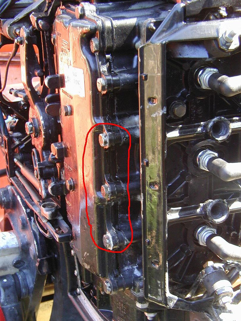

hey guys there is water leaking from one of the covers from my engine, I would go ahead and take it apart but due to the ammount of bolts that is used Iam not sure if I should without knowing what Iam getting into, anyways the pic with the red circle is where the water is leaking out of there is still water coming out of the telltale, but Iam concerened, anyways just wondering what this piece is and if I should replace the gasket right away and if I can cut my own gasket, or if I should buy the proper one thanks again guys.

oh its a 75, merc 650, 65hp.

Looking at it again, I realize that I'm looking at your exhaust manifold water jacket and cover.
Sorry for the erroneous previous post. If you'll look closely, there are 2 covers with gaskets attached to the block.
The outer one covers up the water jacket; water is under it and over the inner (second) one to cool it.
The inner one separates exhaust gasses (from the engine's exhaust ports) from cooling water that's used to keep the engine from burning up from hot exhaust.
Not a problem to remove both covers and install new gaskets. While you're in there you can see your pistons and rings and inspect for carbon buildup on the side and top of the piston.

ill bet its leaking because its full of corrosion behind there. id put a new gasket on it but im the kind that likes to tear things apart. if you do take it off. be prepared to put in helicoils. the stainless bolts will come out with the threads in the block.next time you run it put your hand on that cover and see if there are hot spots on it. if there are worry about it, if not dont worry. youll need two gaskets as well and they are both different.

Jay, I would check it for hot spots after it has run a bit. If it uniformly cool, and you are not getting water into the cylinders, see if some Hi-temp silicone sealer will stop the leak. If it has hot spots, or you are getting water, you will need to remove it.
If it has been kept in salt water, removing the bolts will be difficult. Use heat, penetrating oil and an impact driver to try to slowly work them loose. Heat the bolt, and as it cools spray with JB Blaster or something like it, and then use the impact driver to gently try to loosen the bolts. Repeat as necessary. Purchase new gaskets, and if the inner baffle is not corroded through, it may be reused. Check the inner water jacket cover for corrosion holes as well. If that one needs to be replaced, use the same heat-oil-impact procedure, however visit a house of worship before the procedure and pray for devine assistance, as you will likely need it to avoid breaking some bolts.

well today I squeezed a bunch of 4200 in there,and smeared it all around, did 3 coats with the stuff all together, it was a very small leak not much bigger then a pinhole, so if anything will seal it without taking it apart i think my job today will, there were no noticable hot spots on the cover, so in a couple days I will let you guys know how it went, if it still leaks I guess i will tear into it and replace the gaskets, and whatever else I need to...
