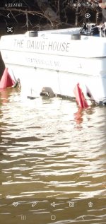

I measured 14 1/2 inches i used this picture as a reference i measured from the water level on the picture to the top of the transom then from the top of the riser elbow to the stop of the transom subtracted the 2 and got 14.5

Ok judging by your pic you’re not sitting low in the stern, mine sits lower, the waterline on mind is right at the top of the part of the transom mount that moves side to side. As in right under the trim piece that says OMC on it. You seem to be an inch or so higher. I measured my static water line and it was 14”. So I think you’re ok there but need something to keep water from rushing up the exhaust.
