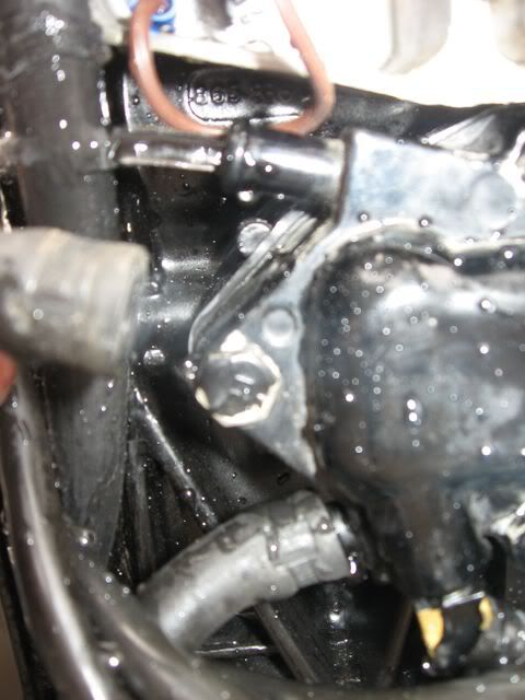

1985 Merc 60hp. Compression's 100/110/110
While changing the fuel pump diaphragm and gaskets, I noticed water came out of the hoses going to the crankcase. At the time, I dismissed it as a fluke and reassembled. Lake test allowed us to run up to WOT for about 30 seconds, then would only idle us back to the ramp.
Had no water in crankcase-to-fuel pump lines today (after sitting overnight). Blew out w/ compressed air. Started motor in a bucket of water, ran 60 sec, and about 1/2 gal water came out the lower hose.
So, water drains out after sitting, which is good, but it fills up when it runs. Any ideas on what I need to look at next?

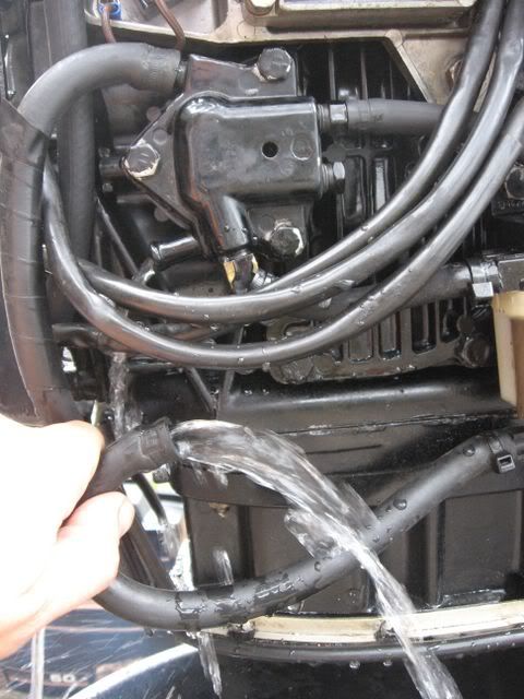

Well, something's not right. I don't think there's supposed to be water flowing through there.
While idling, the lower crankcase tube gives a straight stream of water, no pulsing. Upper crankcase tube has air pulses in it. Water flows out of the pump when the upper crankcase tube is detached.

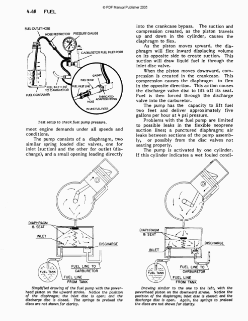

I really should not be wasting the time uploading this but you seem to like pictures, here is one right out of a Mercury Service Manual, I would not know how the pump works after 50 years repairing outboards but a picture might satisfy you.
Joe_the_boatman
Apr 14, 2005
482
Re: Water through fuel pump - Help! (Pics)
Laddies, don't be so grumpy. Sorry for doubting you. You're not wasting your time, you're helping me out here, and for that I'm grateful. You help out a lot of folks here and I'm glad you read my thread.
Looks like I need a better shop manual. I still don't understand the role of a constant stream of water on a displacement pump (and, I'm a mechanical engineer), but for now, it looks like it's right.
