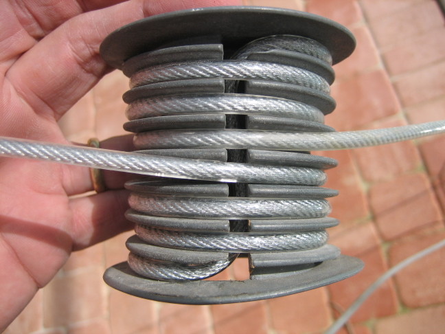

Wanted to share how I approached the installation of cable steering on the Water Wasp. I'm guessing many of the WW's have the same type of steering drum which has the spiral grooves, considered to be one of the better designs. You can google boat cable steering and there are alot of good articles out there for laying it out. I have found that removing the steering drum is the easiest approach. I purchased 25 feet of 5/16's cable at Lowe's. Find the middle of your cable, place it in the cavity of your steering drum that runs across it top to bottom, grab the cable end closest to your steering wheel end and wrap it around the drum following the grooves coming off the top of the drum. Do the same for the other half, (port side), again coming off the top of the drum. I tie it all down with rubber bands to hold it in place, see pic. Re-install your drum. Run your cables through their pulleys. I start on the port side, securing that end of the cable. I use a spring on the starboard side to allow for tension, see pic. Remove the rubber bands on the steering drum.
