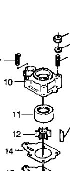

?????----Shown as item #41 on the 1990 to 1994 model ----gear housing ---diagram.
Looks like that is not the full diagram. Does not show anything above the waterpump like the diagram you and I have looked at

I would but what bearing in the top housing? New top housing has no bearing, old housing doesn't have one, parts diagram doesn't show one. #11 is the cylinder that the impeller inserts into.
