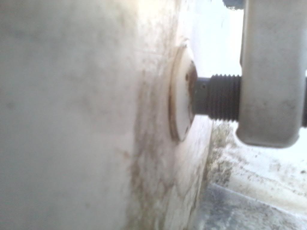

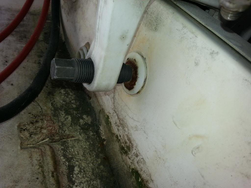

For added comfort could I put a aluminum plate under the engine clamps to keep them solid?
The clamps are only a little sunk in I belive from overtightning. I believe this would help.

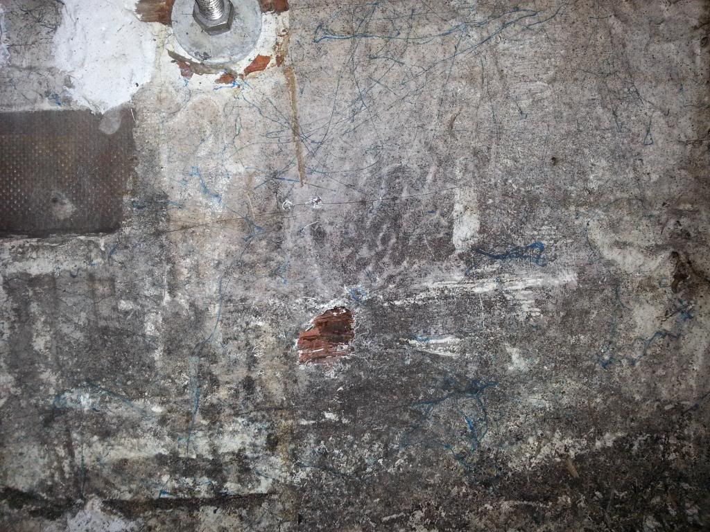

sorry yes, ive already done drill holes througout.transom. they had dry good wood feel to them, also.had a redish tint.

Yes I have drilled into it, the shavings were not bright , they had a redish tint. seemed dry though.
The reddish tint could be the color of the resin or wood used or it could be definite signs of already rotting wood...
Why don't you post up pictures of what you have found and where???:noidea:

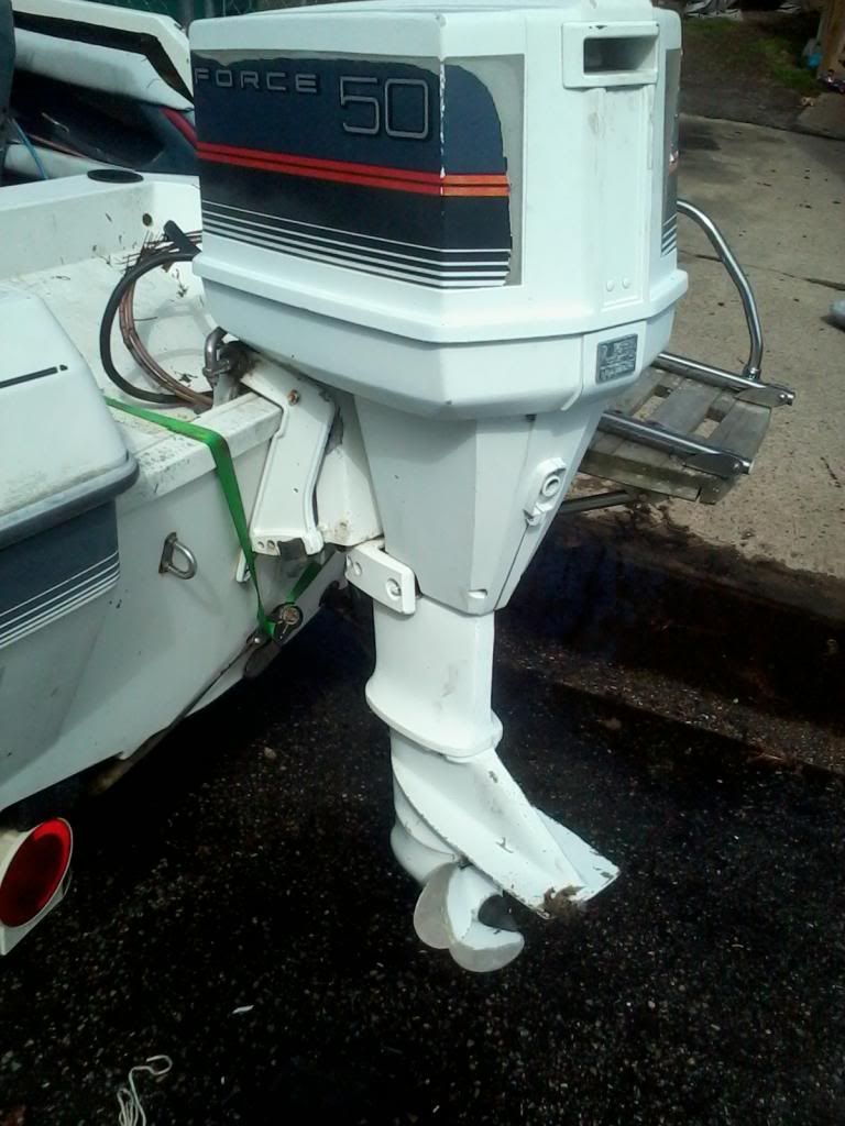

Yes I can bounce on it with no flex, at least none the eye can see and the whole boat comes up in the front.
it is a 1986 Bayliner Capri 14ft with a 50 hp Force outboard.
id be alot more concerned if it were a 23' with twin 150hp,

One thing I know...You should not be able to sink the tightening clamps into a solid, sound transom. The other thing I know, is if you can bounce on the lower leg of the motor and not see any flex in the transom then there is no imminent danger of it failing. If the core samples are dry then use the boat and enjoy it.
Thanks Woodonglass, I think the clamps were overtightened,
they are only sunk in a little bit, like into the glass it seems. but there isn't any flex as I said.
im gonna run in and see how it does, ill check a few more core samples and ill look for any cracking in gel coat etc after the fist shake down run.

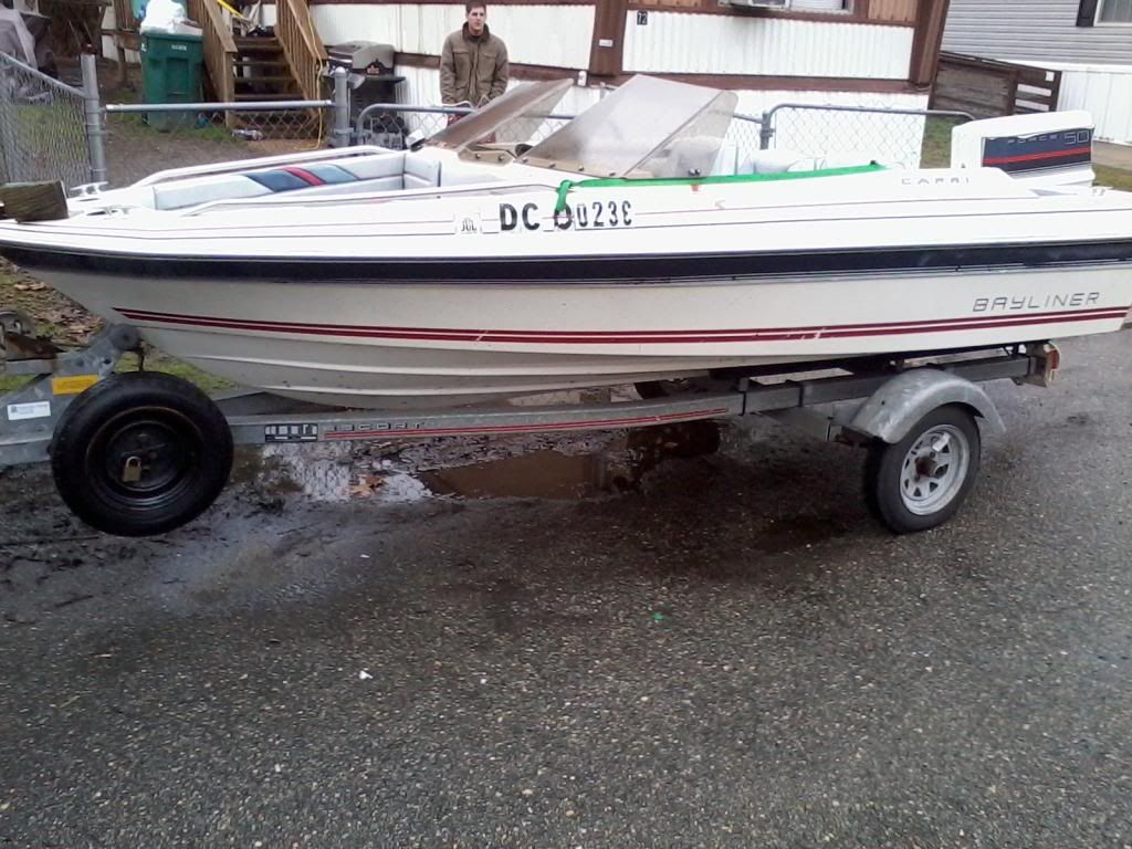

1986 Bayliner Capri 14 foot with 50 Hp Force outboard
Unfortunately agreed sir lol
Ive saw tons of neglected Bayliners myself.
this boat is NOT a polished turd lmao! it was all original when I bought it.
Still in decent shape, but interior was showing its age.
its the original engine and all, and its belived to have minimal hours on it. and was trailered not slipped.
So im thinkin this bayliner doesnt have the typical rot issues from not actually being in the water alot.
However I understand possibility of it not being properly stored and aged sealant could still let moisture in
