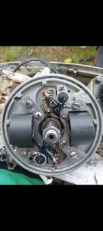

I've restored a 1966 johnson 6hp. I've completely replaced the whole magneto system so coils, condensors, points, ht leads and spark plugs. I've set both points using a volto meter and ohms using the points on the flywheel. The bottom cylinder sparks perfectly and starts first pull and runs smooth on one cylinder but the second cylinders spark is weak and won't run bu itself. I've switched the magneto parts between the two cylinders and still the same cylinder has little to no spark. I'm so confused and can't seem to figure it out

I've pulled the flywheel and replaced every part of the magneto which is why I'm so confused

Did you swap condensers to see if the weak spark follows?

I feel like such a rookie right now. Swapped condensors and boom runs well. I know assuming is bad but I assumed that new out of the box condensors wouldn't be bad but I was evidently wrong. Thank you so much for the help I genuinely wouldn't have thought it would have been them due to the fact they are brand new and would have just kept overlooking them
