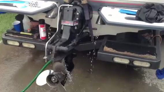

Yeah I just got her back together and took it on a test run on Tuesday, the boat ran awesome, I replaced the bad valves and went ahead and lapped all the valves in. The cause was I had 2 loose spark plugs that leaned out the cylinders and caused the intake valves to distort, but a little bit of work and she is running, here it is when I fired it up
http://i25.photobucket.com/albums/c64/mugg9mm/IMG_2299.mp4
