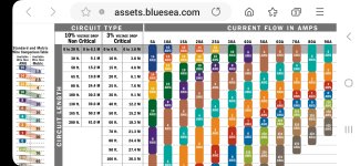

Also don't exceed the ampcity of the wire size
