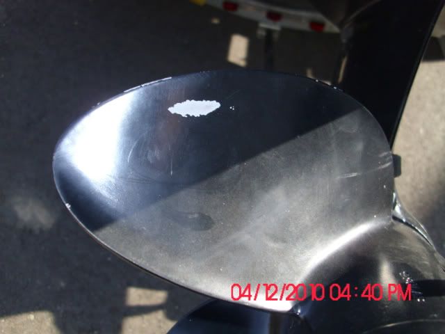

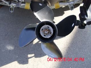

Last year I started using a solas Amita 4 blade prop on my suzuki suzuki 115 DF. its a 19 pitch and I had to get it worked because I was overreving and its still over the 6000 rpm that I should run at WOT.
I noticed this year that I have these marks on my prop.
I am having cavitation problems?
I would like to find an 4 blade aluminum that will keep just under 6000 rpms.

Cavatation burns..... the paint is burned off. Read through the prop section and give us more detail..... weight of your boat.... how the engine is mounted (it might be mounted too high)..... verify that the tach is reading right..... there are many factors but, yes those are cavatation burn marks
Please in the future limit all your pictures to 640 x 480 ;)

Here is the information I gave to HSWIII before putting on the solas AMITA 4 13.75'' x 19'' that I got a propman to add 2'' extra cup after I tried it out. After the work was done on the prop the amita 4 runs at 6100-6200 WOT. the cavitation plate is level with the bottom of the boat. Any information will help.AT WOT with the Amita I am running 39.2 gps speed

Original when I bought this year, bought the 14 x19 to get better holeshot but It ventilates
17. Does the prop show any damage that you can see,
No
18. What problems are you trying to cure or what are you looking for the boat to do that it is not doing the way you think it should or to your expectations
Better holeshot, and better handling it ventilates a lot if I am not at full throttle and when I trim or try to turn. I am not trimmed up that high and it ventilates. If there are some waves its worst.

If you are running 6100 - 6200 at WOT with what you consider an average load I would not change a thing. Next time you are loaded heavy the extra RPM will be to your advantage as loaded the RPM will drop to 6000. You have a throttle so if you don't like 6100 pull back a tad. Speed will be impacted only slightly.
