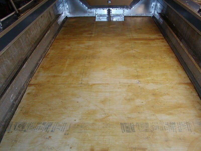

Re: what carpet should i use
My aluminum boat had outdoor carpet and the floor rotted from being wet most of the time. I have just replaced the plywood. After it was cut to size I put two coats of outdoor primer then a coat of marine carpet glue then another layer of marine carpet glue with a 1/8th thick troule...then the Nautolex $15.15 per yard from this site...
