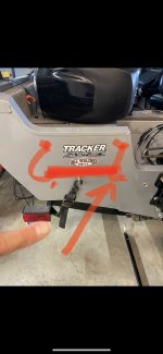

Got all the screws out of the back deck. But I removed some of the screws from the side pieces but still can’t get the back deck off. Am I missing something here guys?

They seem to out screws anywhere thay want, so keep looking, probably buried in the carpet where you cant see them

Do ya think that whole side piece has to come off to get the rear deck off? Maybe there are screws under the side piece? But the wincreen sits on this?

Who knows, but boats are normally screwed or rivets to hold the panels in place, unlike a car where clips are used.
