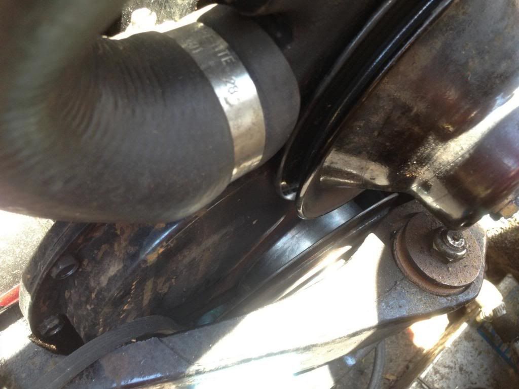

I was out on the boat yesterday and the belt came off. when i got home and dug into it this is what i found....It's a 3.0 mercruiser from an 88 caravelle. I found pieces of what looks like a gasket that goes inbetween the two, my question is is that all that should be there is the gasket, or am i missing something else?

Looks like you are due for a new harmonic balancer.

Re: What goes here...
so that rubber gasket that was there is not replacable? I have to replace the whole part?
No repair. That "gasket" is actually a rubber ring that is bonded to the outer pulley, and the inner hub.
Yes, you need a new one.
