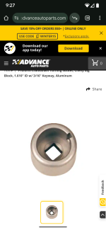

Never turn a Chevy motor from the crank bolt. You will usually strip the threads from the crank before budging the motor. Always use the flywheel or pull the damper and use a crank socket
Pull the drive, pull the plugs, see if it turns over from the starter
If it does, check the drive if it's locked up
If it doesn't turn over with the drive off and plugs out. Pull the motor

Agreed on the crank bolt. Only safe way to do it might be to remove all the plugs so there’s no compression to provide resistance….
