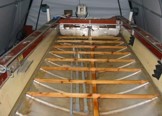

I have seen guys lay their plywood floors out so they need to actually scallop the edges of the plywood to clear the ribs on the underside.... why cant you lay the play wood higher and let if protrude into the inside of the strake fold?? thats a perfect landing for the edge of the playwood. I have a 56 gallon fuel tank and if i stick as far foraward as possible i can lay playwood over it and have it sit on the tops of the ribs....but it almost fits onto that strake platform.....enough to just let it have that ( possibly 3/8" bow up in the middle) rise....
I figure Ill just move the stringers up the ribs to accomodate that level.....seems prefectly reasonable tyo me....but id figure id ask.... this will be my first starcraft floor.

Hey Bob... can't say 100% for sure, but it will likely be quite tight getting the wood in place. Perhaps on your boat it will be fine. I had thought about it too... but ended up opting to stay with laying the floor on the ends of the ribs and 45'ing the edges to get it closer to the outsides. Also, will you be able to rivet/screw it to the ribs if it is up off the ribs? Riveting/screwing to the strake fold would be ummmm problematic! :D

Hi Bob, I've raised the floor on a center console using cedar that I ripped down to size so that the sole mates-up with the fold. Attach the ceder to the stringers and the sole to the cedar. Very solid...then again I used 3/4" PLY and glassed top & bottom (pre-iboats). I suppose the downside is that you're raising the center of gravity and making the boat a little less stable.

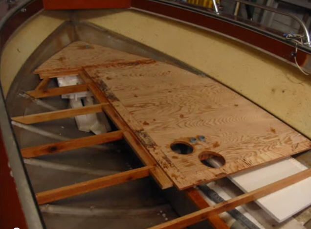

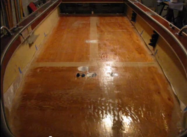

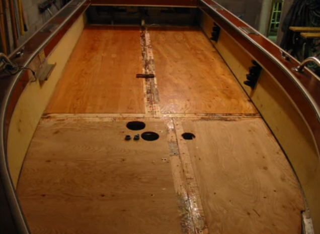

I did similar to BlueFin16.
But....
I replaced the original 1/2 ply, didn't like the springy feeling.
So placed another 1/2 of ply over the top. But I seamed it similar to BlueFin.
This way I was able to cut the ply larger, to fit it into the strake fold.
All the ply was sealed, then the top layer was glued and screwed down.
It looks "more finished" with the floor fitting into the strake.
