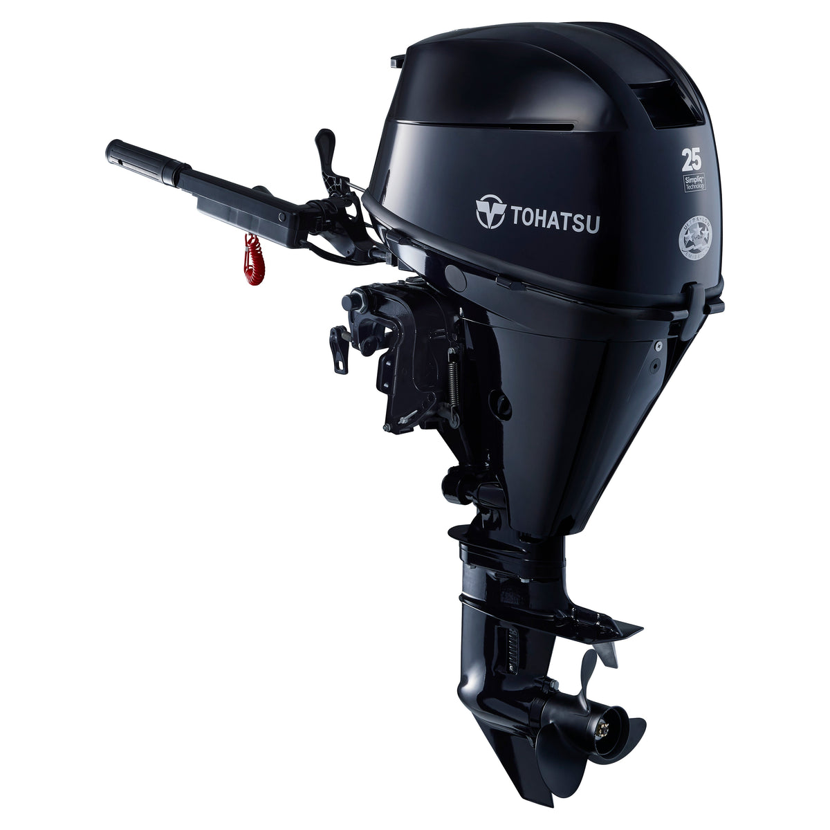

Just for closure, I bought a 20 hp Tohatsu pull start motor new for about 2700. Great little motor, I can't believe how long a little 3 gal tank of gas lasts. Goes plenty fast enough for my needs. Idles a little higher that I would like but all in all, I'm happy with the motor and I know that I can depend on it. Thanks

Made in Japan Tohatsu, they also make all the small Mercury motors.
