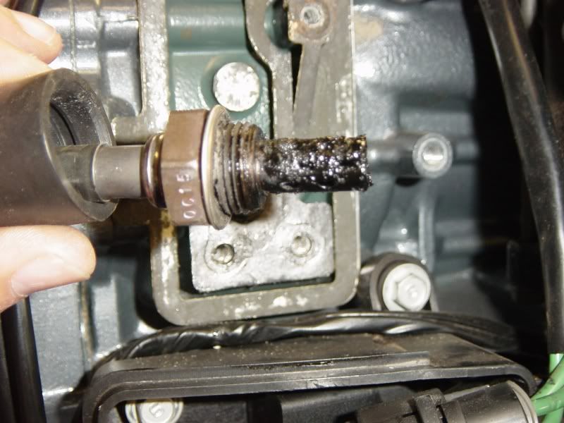

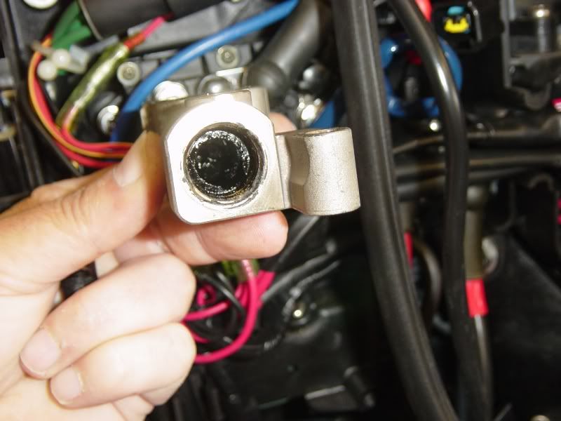

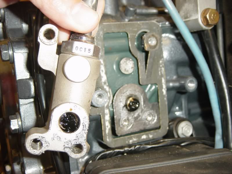

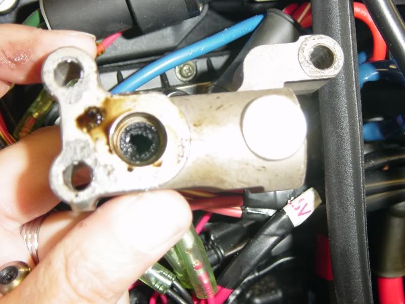

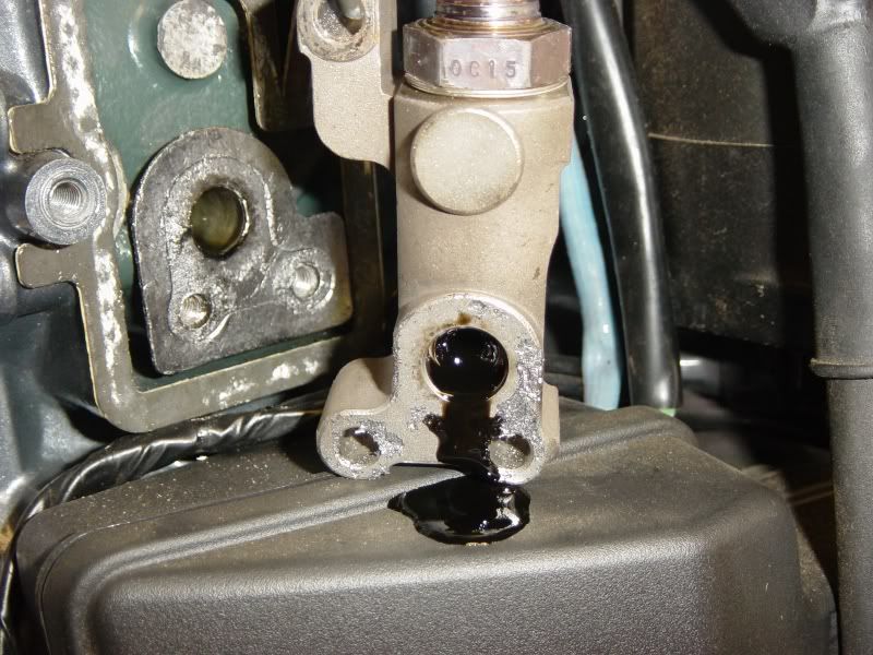

UPDATE: I pulled the o2 sensor off today on a hunch that it would be clogged after reading about some other guys have similar over oiling on their similar vintage engine. Sure enough look at the pics....I spent a around an hour cleaning the housing, tube and sensor. I am going to go out in the morning and run the voltage test. I have a feeling that the sensor will never be clean enough again to operate properly. I tried the combustion chamber cleaner that was recommended by Cousin. This carbon was really tough.
will update later.

For the oil linkage rod adjustment, disconnect the butterfly linkage on the starboard side of the motor, just the bottom set. This will allow the oil linkage road on the port side to seat freely. Use a feeler gauge on the oil pump, I have read .020 and .005. I used .005. on the oil pump, measure between the oil lever and stop. You may have to cut 5 threads off of the linkage rod to screw the plastic collar down enough.
For your O2 sensor cleaning, I use my wire wheel on my bench to remove the bulk of gunk and then soak in Techron, Cumbustion cleaner, RingFree or Seafoam. For the housing, I used a dremel tool with wire wheel to clean out. for the draw tube, I used dremel with a drill bit.

Great pics. I think you're on your way to getting that smoking problem under control!
