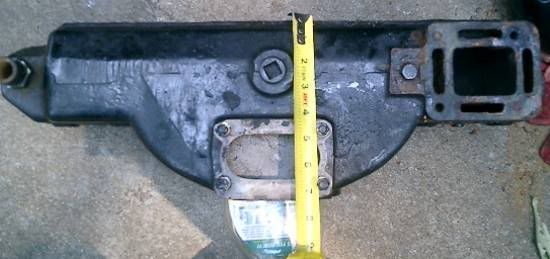

I don't know what they look like, but the Mercruiser PN for that SN for a 3.0LX should be 806867A12

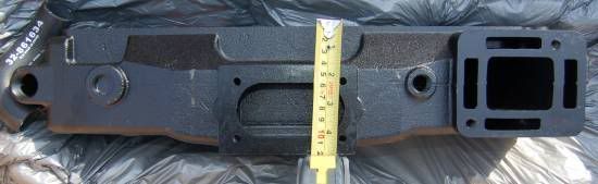

Ayuh,....
The picture in your post #3 doesn't show Anything,.....
In the 1st two pictures,.....
Is the Right 1 an Aftermarket manifold,..??..??
It Looks like you could cheat the 2" difference,+ use the 1st 1 you posted.....

Personally I have never seen a 3.0L with a manifold like you are showing in your "Correct" picture.
I think Bondo has it pegged. You have some aftermarket manifold on there now. So getting the proper one will just put things back to normal.
