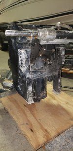

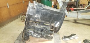

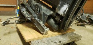

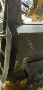

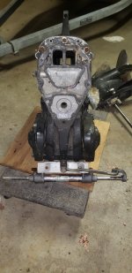

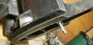

what merc mid section is this?!
Josephmcg
Seaman
Aug 15, 2017
70
i know this came off a 2.4 200 that my buddy thought was a mod vp, but the ram on this unit is massive and there are holes in the bottom of the exhuast housing.. i posted a bunch of pics, any help would be greatly appreciated.

it "looks" ta be early high performance bass mid.. pre '89.
tha term "mod-vp" is used loosely with description of high performance side of merc.. hi perf. stuff can be an assortment of different motors and mids....
tha "single ram" mid was standard till 'bout 83.. then tha three ram became tha standard production mid.. tha single ram remained with hi perf. stuff.. its stronger and has full range with any rpm/load where tha three ram has limited "trim" travel....

Has a 1 piece adapter so cooling is a tad different than stock mota

no.. its justa production down housing with no liner and those holes drilled for an "open" sorta exhaust.. little quieter than tha hi perf offshore down housing... clamp and trim is same as hi perf "offshore"..

so if i wanted to use a 3 ram mid, would i be able to use the 1 piece adapter from this? or would it be better to use this mid?
Dukedog
Oct 6, 2009
3,520
i saw your post on S&F so you have one complete mid and one that is missing one piece of a two piece adapter plate.. is that right?.. you can.. they all will interchange but there a few tricks involved.. tha one piece has different size threaded holes for tiller bolts is just one of 'em.. depending on which tiller arm used it can have a different height shoulder also.. then ya have tha different coolin like faz mentioned.. it boils down to whoever makes it a complete mid, ready for a power head, needs ta know what they are doin'................

if ya want to try and do this and have some mechanical knowledge we can probably get ya thru it... i can email ya a few things that identify parts and things..
