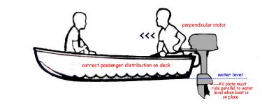

With tiller, manual trim motors the trim must be set at 90 deg at whichever trim hole dials so. Perfect to have a driver at the tiller, a boating mate sitting up front. (1) To get the max HP out of that motor must prop it right to run towards it's max wot rpm range factory stated which is 5500 rpm. Assume the current motor's shaft lenght (whether 15 or 20) is what the boat manufacturer designed it to run with ?
For a correct prop maximization will need to buy a cheap induction tach (2) install it next to the tiller grip, adjust the firing sequence to 2 cylinder, 2 sparks per revolution, go for a wot run on flat calm water cond and report the max wot rpm the motor achieved with 2 up, with current prop surely the motor runs extremely lugged.
To determine if there's a correct motor/transon height match will be ideal once the combo it's on plane to visually check (3) if there's any water splash in/out transom going on, prop aertion on choppy water cond and very important at which lower leg height if the water flow is currently passing by, is it right under the upper small plate or towards the AV lower plate. Report your findings.
As the under powered 15 HP motor is powering a large boat would suggest based on a wild guess to drop at least 2 pitches to an alum 3 blade niner to increase wot revs, but with an installed tach will be able to fine tune a better pitch prop to run towards the full wot rpm range with a fixed load of 2 up.
If that boat floats high, has an efficient hull shape with min hull drag, correctly propped wiill be able to achieve a faster plane as loaded than before.
Happy Boating
