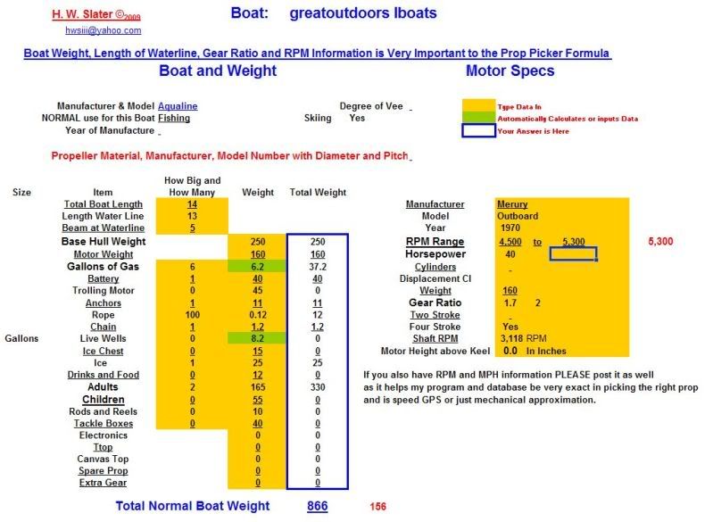

Hi Guys. I just bought a Mercury 40hp motor. The gear ratio is 2.0 It has a 11" diameter and 12" pitch prop. My boat is a 14' semi v that when all told with passengers and gear, motor etc, is probably at 850 lbs. It is rated for a 30hp tiller and 45hp console motor. The boat rockets out of the hole and gets on plane very quickly, rides on about the last two feet of the hull, and I'm near 40mph, if not, then I'm at 40. I don't have a tach. The WOT operating range on the motor is 4500-5500. I would imagine the engine is near the top of that range with the small pitch prop. I would like to gain top speed while dropping the rpms a little. So, I would imagine I would need a higher pitch prop, correct? What size would you guys suggest? The information I gave is as accurate as I get get at this point. Thanks.

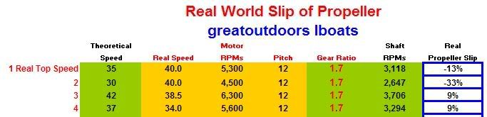

Your numbers are incomprehensible because using 4500 RPM and the other data you supplied yields negative slip numbers which are not theoretically possible. Using 5500 rpm and the same data slip is still negative. You don't have a tach yet you want to drop rpm and gain speed. That doesn't happen unless you are extremely underpropped (engine is over reving). If the engine is over propped (not reving in range) then adding pitch will likely slow you down and lug the engine to its early death. You need a tach and accurate speed data (gps) to know what the engine is doing before spending money on props.

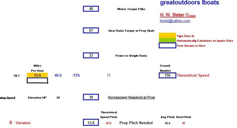

Great, I have been reading your past posts and I have to tell you that you are working in the dark when you don't know how many RPM and how many miles per hour you are going. If you will look at my number 13 you will see you can buy a tach and hour meter for $ 35 for your motor, just remember it has a short wire and has to be mounted close to the motor and you cannot add to the wire. And I am sure you know someone who has hand held GPS or even some cell phones have GPS built in so you will have a true GPS speed.
I also looked up the information for your 14' Aqualine boat but ouldn't find anything about it. When I looked up your motor I found that a 1970 Mercury 40 HP should turn 5,300 RPM at WOT and has a gear ratio of 1.7:1, please verify this. If you will fill out my form it will show you how to KNOW what the real gear ratio is for sure.
I also ran prop sliip numbers using the gear ratio of 1.7:1 and a true 12" pitch prop, if you are turning 6,300 RPM your maximum speed would be 38.5 MPH, but you would definitely be running past maximum RPM too much. In my opinion you are probably running about 34 MPH GPS speed.

Thank you. I borrowed a GPS from a friend today, so I will be using that on the next trip out. Tach wont be here for about two weeks. As for the gear ratio and WOT, I got the info here under 40hp classic. http://www.marineengine.com/parts/prop/wot_prop.html
I also found some specs which match yours, but my motor is a model 400 and not a 402. So, I can't be totally sure until I do the test. Found those here. http://www.piranha.com/motor_specs.php?id=3816
I can tell you that your numbers seem to be accutate except for beam at waterline which is 49". I will fill this form out as soon as I am able to install the tach and provide you some more accurate numbers. I'll PM you when I do as it may not be for a few weeks. Thanks again.

I got the boat out today with the gps. I hit 28mph, but I had 3 guys on the boat, 225lbs, 200lbs, and 180 lbs and a bunch of gear. I was also running up river against the current of the Susquehanna river. It was a 3 mph current, as we were drifting down according to gps. Couldn't get to the lake to try it with one guy and no current. I was pretty pleased, I didn't think it would go any faster than around 22-23 with all that load. Tach should be here by next weekend, so I should be able to fill out the form then.
