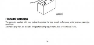

I just want to know where in manual/s and which MFG's states after break-in to re prop..
Here is from Merc/Tohatsu manual..
