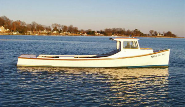

which boats are designed to last 100 years?
Lots of 50-60 year old work boat still in daily use on the Chesapeake. Still have a few Skipjacks still working that where built in the early 20th century.
No carpets, no reclining seats, and the cup holder, if they have one, is most likely a short piece of pipe bolted to the hull.
This one is 56 years old. Lived in a slip it's entire life. Doesn't know what dry storage is. Bet the owner doesn't have to dry out the bilge with rags to keep it rotting away either.
http://www.yachtworld.com/boats/1953/Chesapeake-Bay-Deadrise--2051690/Burgess/VA/United-States
