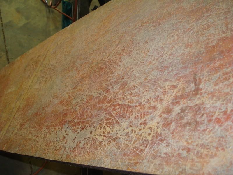

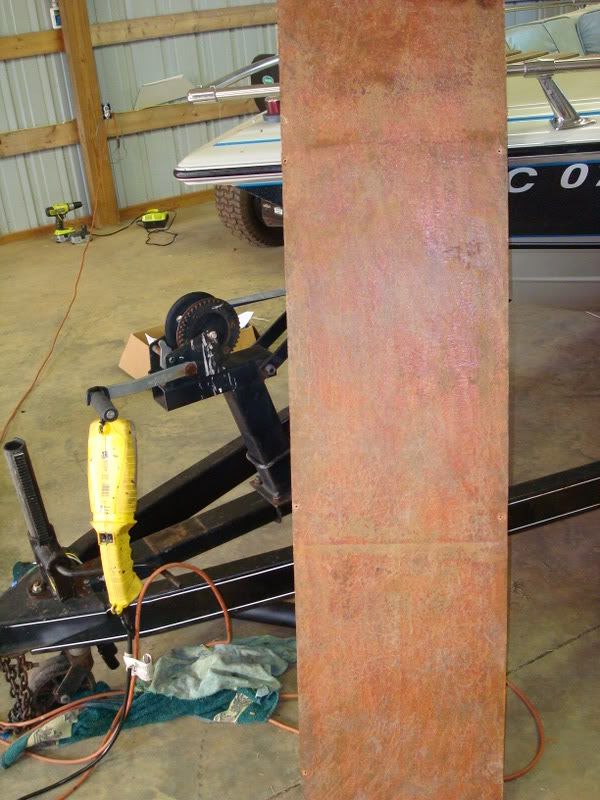

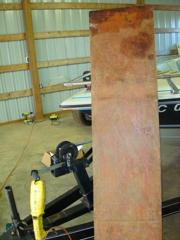

thanks for the replies! but now I'm really confused which it is..I pulled the carpet off and on the side the carpet was on I atleast can't SEE any knots.
and look at the finish I can see what looks like fiberglass strands....and a hard finish on it what kind of finish is this? but the other side looks like just spar varnish on it.
here are some pics of the carpet side with the carpet off.
does this side not look of better quality? maybe it might be BCX.. this side being B quality and the other side with the knots the C quality side? or no?

I agree the carpeted side looks to be much better finish quality, probably to avoid depressions in the carpet due to knots. It looks like they just put one layer of mat on that side to strenghen/waterproof the top(carpet) side and then just thinned or straight resin on the under side and edges to seal/waterproof the rest of it. One layer of mat flat like that doesn't add a ton more strength but you could do the same if you wanted when you re-build. Is the piece soft? it looks to be in pretty good shape just wondering why your re-building it? I think you will have better luck finding ACX readily avalable over the BCX, but might be different in your area. Its up to you but if you use epoxy resin instead of poly that project is not going to be cheap...
good reply, thanks
ok to start with after seeing both sides is it cdx, bcx or acx?
2nd what do you mean by "mat" and where do you buy it? something i can do myself?
and the finish is that epoxt resin of the "mat" or poly resin or what?
and yes on the under side some spots are a bit soft and the 5 ply layers are coming apart in some areas I just want to replace this middle pull out board only the rest of the floor is rock solid. I wouldn't think it would cost too much to redo this section the way this one was done with a new piece of plywood.

To me it looks like BCX or you could use ACX depends on avalability/price. If however you can find a nice piece of CDX might as well use it strength wise it makes no difference. Generally fiberglass construction consists of layered materials that are built up with resin as the binder of it all and then a finish coat of some sort. Usually you go a layer of mat(large strand fiberglass) then a layer of cloth(like fiberglass fabric) then repeat until you achieve the desired thickness. then top coat gelcoat paint etc. There are lots of different types of mat and cloth. The reason I said it isn't all that strong is because one layer of anything doesn't add much strength. In that application it would help with the ridigity of the plywood a bit and also waterproof it. Yes it is something you could do your self, any boat shop will have fiberglass repair kits or products to handle the job. Lastly there are two types of resin (binder) you can use poly or epoxy I would reccomend the poly for that job. It is much cheaper, more products are compatable with it, and boats have been built with it for MANY years with great success. If you get a kit that has everything included it will make the job easier plus give you step by step instructions on how to apply it all make sure you follow as closely as possible.

Well now after seeing both sides of it, it could be BCX... but the size of the surface voids on the first side you showed still make me believe that it was sold as CDX at the time.
BCX is a little better on one side than the other... but the other poster about the quality of recent lumber is correct... what they're calling "A" grade plywood now was "B" grade not many years ago.
In any event the long and short of it is this is for a deck..... who really gives a crap? You're not going to get any better service out of one or the other until you move up to cabinet grade wood and that's a total waste of money.
It was done on the cheap when first built and has lasted a good number of years... I'd buy come CDX or BCX, hit with some poly resin.... maybe it'll penetrate well maybe it won't and throw a sheet of mat on it.
If carpet is going over it no need to top coat it with anything.... UV is what breaks down the glass.
It'll likely last another 15-20yrs of normal use.
Personally I never use Poly on wood, but for a deck on a boat that you likely won't have 5yrs from now it'll save a bunch of money.

I went out and found some 5ply BCX plywood and bought a sheet of it. I cut it out identical to the original and tested the fit...works great!
now all I have to do is finish the wood, I'll just finish it like the original was finished since the original still looks dang decent considering this is a 1984 boat. Which I have taken good care of it and it was my late grandpa's boat which he also took very good care of.
question is we determined the carpet side has 1 layer of mat and some we assume poly resin on it. Do I put a layer of poly resin on it then while thats wet lay some a layer of fiberglass/mat on the wet resin right? then when that dries put another layer of resin on the mat correct? just wanting to know the sequence here..or do you just lay down the mat on dry plywood then put the resin.
that covers the carpet side...
the other side doesn't have mat on it and it actually doesn't look like that hard glassy looking resin. Instead it looks like just a clear varnish u agree?
I plan to just varnish that side OR I may just poly resin and mat that side as well. Not sure.
where is the best place to go that your normal town has to buy poly resin and mat? I live in a semi small town def. no major city.
thanks this forum rocks! I enjoy learning about this stuff and doing the work myself. I'm semi young 25 so just learning!
