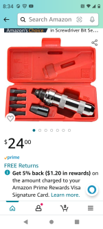

You need an impact driver.
Crosbyman
Nov 5, 2006
5,930
Most of my tuff bolts-screws etc..... have come out easy using a 1/4 impact driver ...starting at the lowest setting. adapters are available to mount 1/4, 3/8, 1/2 inch sockets .
Dollar store adapters for $4 CDN a kit have proven very reliable for home (non-commercial) application with my Craftsman sockets and screw adapters for flat, philips, square & torx
