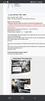

I had to go back and redo things. I couldn't leave it the way it was with timing at 19° BTDC, it just didn't look right. I attached a picture of what that adjustment bolt looked like, ready to slip off the plate when adjusted at 19.
I kept digging around online and came across another forum from 2011 on marineengine.com. I believe Racerone helped out on this issue 10 years ago! I was lucky to find that thread and included a couple of snapshots of it. It seems timing should be 3°±1° BTDC. I went by racerone's advice and ran the engine until I had it right about 3° BTDC with the timing light and at first it wanted to die down but then adjust the cam plate to just barely start touching the roller for the carbs and that steadied my idle out. Seemed a tad high at first but I was running on muffs. Luckily I had a 55 gallon drum laying around, cut it in half and it made a decent tank to run the engine with some backpressue from water. Idle seems to be smooth-ish. At least as smooth as I think I can expect from a 2-stroke this old. Cut the engine off and double checked butterflies, completely flat at WOT. I feel more comfortable seeing that adjustment bolt sit in a much more natural position and backing right onto the plate instead of ready to slip off the top. My adjuster now looks a lot more like the one in the pic from that other 10 year old post and measures a lot closer to 17mm as Oldiron had mentioned... not 30ish, turned just about all the way in, like I had it last night... here's to hoping I did something right
