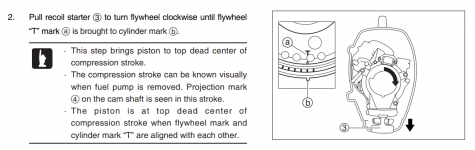

Thanks, if the exhaust rocker is removed, then will the valve spring be kept in place? I am aslo having trouble to find the flywheel “T” mark and cylinder mark by the service manual, please kindly let me how to locate them. It's so confusing for a newbie.

There is a keeper that keeps the valve spring on when the rocker is removed. If the spring comes off with the rocker then something is wrong. You may have to remove the pull start assembly to see the top of the flywheel and the marks that you're looking for. Before you go taking the rocker out, first check the exhaust valve clearance. If it's wrong then fix that first and see if that resolves the problem.

You don't really need to look for the "T" on the flywheel, just look for the timing marks on the side. I believe there are two, one for 5BTDC and one for 25BTDC. Either one will do for these purposes, because you just need to know that both valves are closed.

I found the "T" mark on the flywheel. Removed the cylinder head cover, measured the clearances of the intake and exhaust valves, they are just so tight that the clearance is thinner than 0.0024 inch (0.06mm). So I adjusted them by the manual, did the compression test, the reading is 75psi. but it's supposed to be 49.3 psi. I believe I have done something wrong. Now it has become very difficult to pull the start rope and could not start the motor. It feels like the piston refuses to move by creating a vacuum. Now the problem has been changed from not enough compression to too much compression. I need to continue to work on it to find a way to start the motor. Thanks for all your help.
