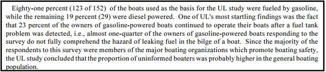

this is scary as hell

Wow that is scary. A leaking gas tank is a bomb just waiting to go off. Mine don't leak. I just want to replace it since my floor is torn up already.
