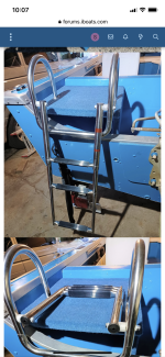

I too was mulling over reworking my splash well and incorporating 2 small folding jump seats in the corners, but they may end up pretty narrow. but I just picked up this swim ladder for one corner, so I’d be down to one jump seat unless I could somehow incorporate a step to the walkover platform. This photo is from another iboats Starcraft forum mate (sorry my feeble memory forgot the member name) and I really quite like it over the swim platform that sticks out the back.

SSM - thx for the info. I like the swim ladder idea as well. That just might get added to the list.
I'm still waiting for the gas guy to hook up the radiant tube heater, so I'm stuck doing 'cold' work in the shop for now. I've been cutting and fitting 5/8" ply to the floor. Next step is drilling and mounting the seat posts for the front two pedestals. The aft seating is still under review. The pedestals I bought are longer than needed, so I'm carefully cutting them down. They do include adjustable height function, although that is reduced obviously as the pedestal gets shorter.
Anytime. If you want to see the ladder full scale, let me know. I’m not far from you.
