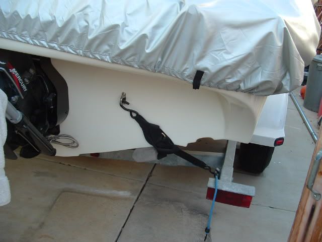

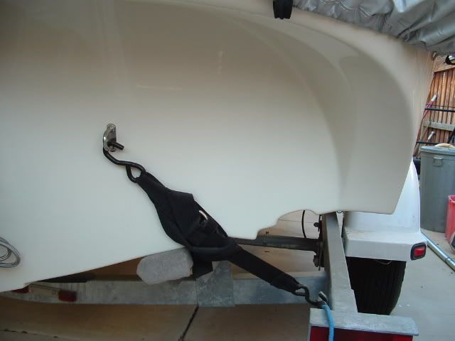

OK I need help as to where to mount these. I have call and e-mailed Nauticus, but with no avail. I need your help guys. Do I mount it like they say 3-5 inches from the outside of the boat just about the cut out in my hull or do I move it over 9 inches or so and mount it on the flat bottom part of the hull right were the tie down is at?? Any help will be greatly appreciated. Here is my hull:

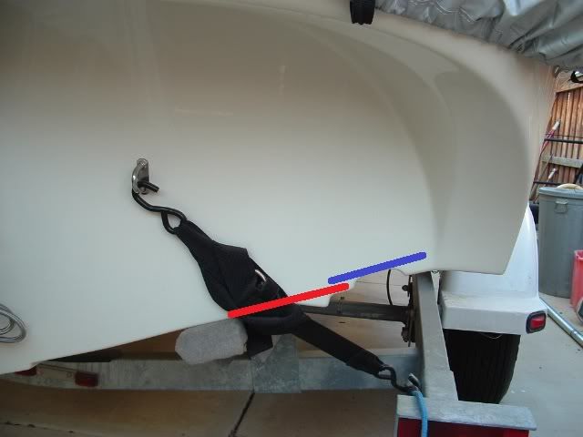

OK so RED line or BLUE line. Help guys...

I don't have the answer for you , but maybe a solution.... email that pic to the manufacturer of the tabs...see what they say.... ;)

They say to mount them as far to the port and starboard as possible, so with that said, I would use the blue line. Don't wait for them to answer your e-mail as they are a little lax in that department, but call them. Greg or John have been great to work with on my problems.

It seems to me the further outboard they are , the more effect they would have. Things might get tipsy the further inboard you go with them....

I thought about that as well, but was wondering if the surface will be too small once I am up to speed as that cut out on my hull is only about 3 inches or so??

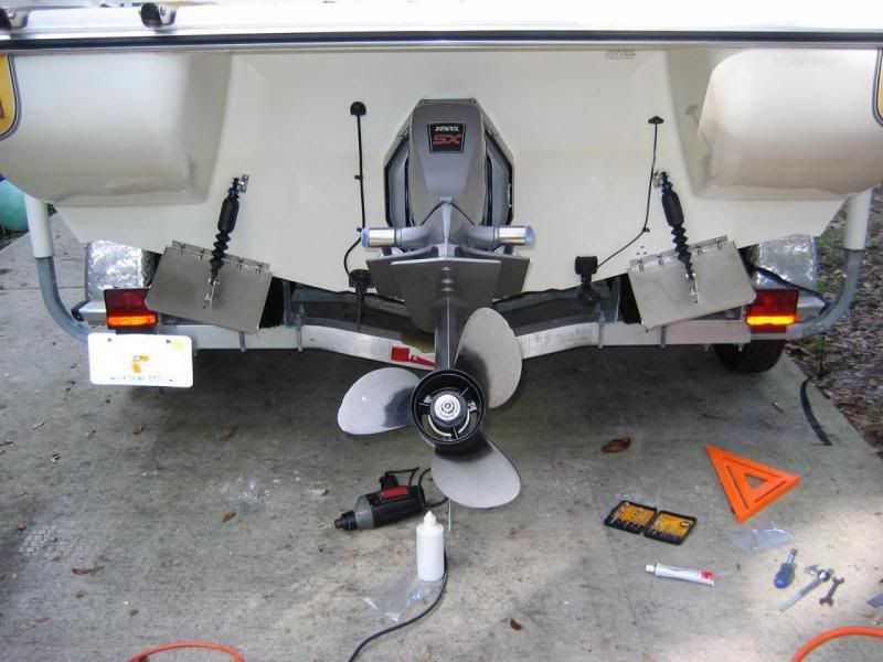

FWIW, here is where I mounted my Smart Tabs on my 2004 Stingray 200LX:

Thanks, but mine is not flat as shown in the pic (unless I come in a few inches). Have you had a chance to try yours out yet with the tabs?? I would also need to mount them in about that distance and am wondering how it handles??

I'd put them in the red position personally. Over a chine is fine. Realyl I don't think either place would be a problem.

First of all let me apologize for not keeping up with the email requesting installation assistance. We are running at a rate of about 300 per day, and in combination with the 100 or so phone calls it is overwhelming. Some people are complaining that we do not answer the phone. What happens is that all the lines are busy at the same time. But we are trying.
Anyway, move the tie down straps so that they attach to the trailer frame directly below the "D" ring on the boat. This clears the area directly above the trailer bunk to mount the tabs. You can pick up an "L" bracket at West Marine or even Home Depot to bolt to the trailer in order to accommodate the strap hook.

Nice install job! I bet they work fine. You couldn't have put them any further out and have the rams on the transom properly like you do. Looks good!
