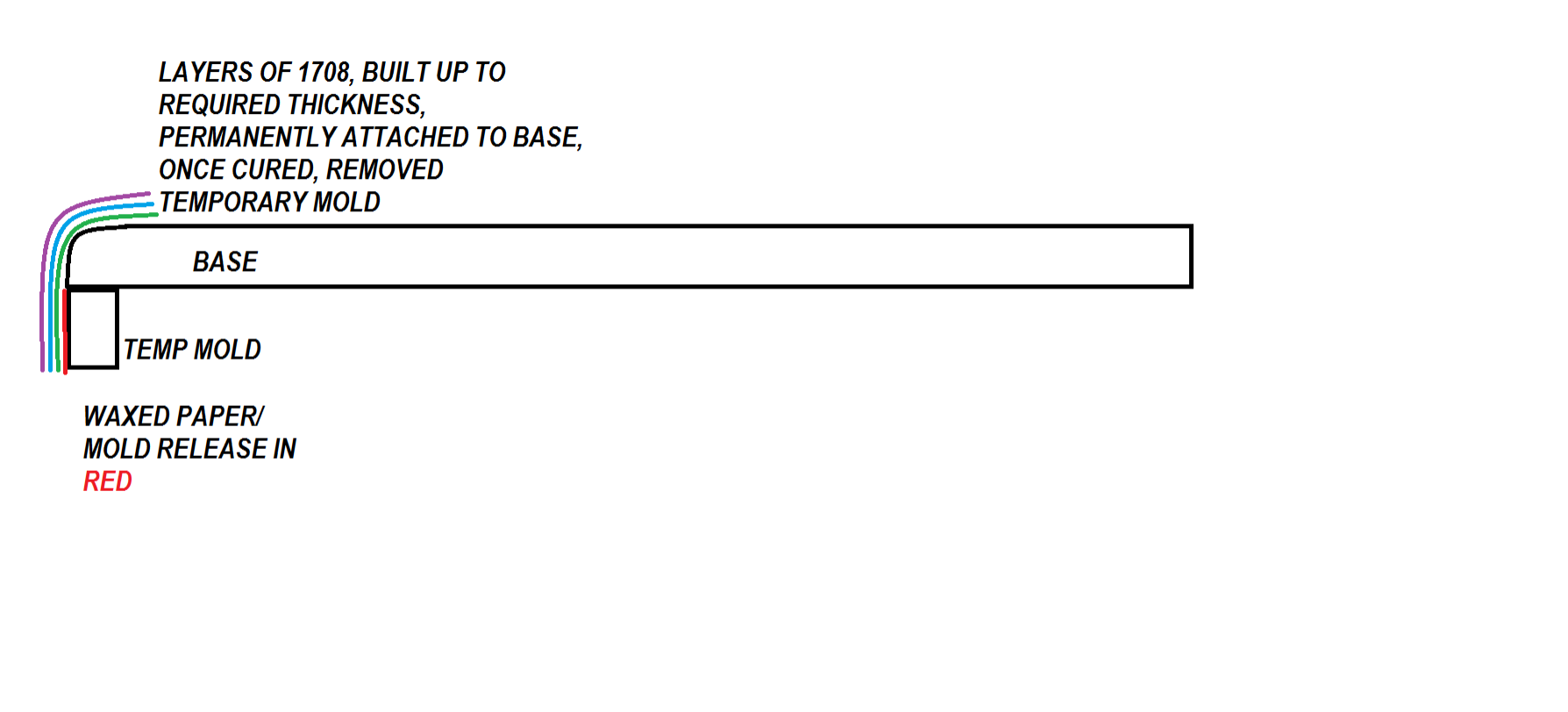

Thanks for all the replies... if I build a new one out of 1/2" or 3/4" ply, how do I build the "lip" that goes around the base of it? I start with one sheet of 3/4" ply as the base, there is a 1" or so edge that curves downward and is used to hold a few screws that go horizontally into the base (on the boat).
GT1000000
Jul 13, 2011
4,916
Re: Where to find a flybridge console
You can attach a temporary form to the base, cover it with waxed paper, then build up several layers of 1708 biaxial cloth to get the thickness you need, then just trim any excess...
