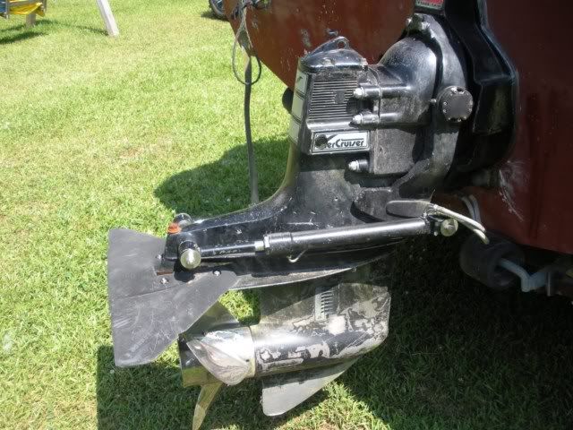

Since I got this boat I've never really know for sure which outdrive I have. I haven't done much work on the outdrive yet, so it hasn't been a big deal, but tomorrow I plan to work on the bellows, so I would like to know for sure I'm going by the correct manual.
Serial number: 5691256
Driven by the great Mercruiser 470, 1978.
I have Manual #05, but that one is for TR-TRS models, which going by the pictures in the manual of the top of the outdrive, that is not what I have.
I also have the Manual #04, which covers the 120-260 models, which looks like what I have according to the pictures in the manual, and it lines up with my serial #.
I also have Manual #06 for the R, MR, AlphaI, but my serial doesn't line up and it says the manual is for 1983-1990... mine is a 1978 model.
So my guess is it's a 120 or 260, but not sure.
Before it came off...

Don, I actually have downloaded the ID & History pdf that you made. I am still confused though because the 2nd chart says it is a MC-I drive, according to 1978 and the 470 motor. But then when I scroll on down to the next chart it shows that it could be the 120/140 or 898/228 or 260 or 470 or TR/TRS, according to the year and serial range.
I want to go by the first chart and say it is the MC-I drive, but I'm not totally sure. And am I correct that it is pronounced "one drive" ?
I can be sure it is a pre-1983 model because of the round top cover with the eye on top.

i got a different chart (mercruiser engine drive model reference chart) from somewhere. someone here on iboats. it states that a 1978 470 is mated with a mc-1 drive.
if a '78 470 you need s/m #3 for the engine, s/n range 4886620-6218036. #4 for the drive. #4 s/n range is 4891650-6216686. your drive s/n falls within that range.
yep, i use the term 1 drive also. see my sig..

Seems the verdict is the 1 drive. Thanks for the info ziggy, I have the s/m #3 and #4 so looks like I'm set.

I think I understand now how you got confused. In the first chart, everything is listed by ENGINE model number, in charts 2 and 3, the drives are listed by DRIVE number.
Your mistake was going by serial number and finding it in several places. The serial number range is for all Mercruiser outdrives for that year or years of a run, and it would include one drives, and TR drives. You just have to stick with the one for your 470 engine.
So following that information, you have a "One Drive" no matter which chart you look at.
