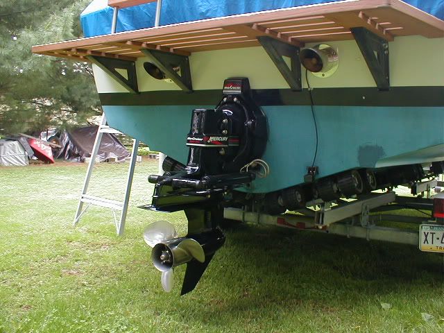

When I bought my Corsa system it came complete with dimensioned drawings showing exactly where to cut and the correct risers. The only additional parts I had to buy were some exhaust hose, clamps, a matching dash switch and some 3M 5200 to seal the holes.
Here's a couple pics.
The transom with tips:
The engine. The Corsa diverters are polished stainless, one is just below the blower:

Thanks everyone for the replies. I dont think I would be up to fabricating one myself. I didnt think to check Hardin so thanks for that tip. Arks it looks like you have totally revamped the old Wellcraft. I used to love those old Wellcrafts back in the day!

Yeah, I had that boat for 18 years. Sold it in 2004 but recently picked up another one, same year and model.
