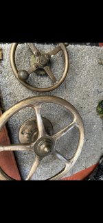

I’m middle aged myself, but was lucky enough to remember my father having a lovely old wooden boat as a boy. She had a kelvin petrol engine in her. To start this engine, it required my dad to use a syringe of fuel (or possibly paraffin) into a port, manually advance the timing and then hand crank her over with the starting handle. She had beautiful brass wheels at the helm..one for steering via chain drive and the other for gear selection. Sadly, the latter and pictured below, is all that remains of her. She’d be over a century old by now at least.
