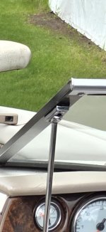

The boat is a 99 1800 LSR and I don't have much history on it. The problem is that center glass overlaps the starboard windshield at the top(fits nice and flush at the bottom) and I've found that if I remove the screws that hold the rod to the serrated plate and allow for about a 3/16" gap then it will close properly. Now I'm pretty sure that I have only ever seen a serrated plate work properly when it's mated against another serrated plate, unlike what you see in this pic. In fact if there was a serrated plate between the rod and the plate that is there, the glass would all fit properly. So am I correct in thinking that it missing it's serrated mate? The rod/plate on the port side looks that same as this one and I feel it is also missing a serrated plate...
Your thoughts are appreciated.

make a longer rod, or buy a longer rod, or grab a bit of composite window shim and make a plate.
however you may want to see if the two consoles are tilting inward, indicating the floor is sagging in the middle. put a straight-edge across the floor and verify.

Thanks guys, that's good advice. I placed a 4' level where you said and at most the center floor might be sagged 1/16" so I don't think that's contributing too much. I did notice though that both padded side panels are loose and that allows me to lift the corner of each console up just enough to close that gap between each rod and it's serrated plate.
Now I just have to figure out how to remove/tighten those padded side panels without damaging them. If it's too much of a pain, I'll just make some shims to go between the windshield frame and those serrated plates.

any sag is a concern to the deck.
there will be fasteners of some sort on the upholstered panels

Also a sixteenth there is different than what that number becomes at a a 4-4.5 foot vertical height.
