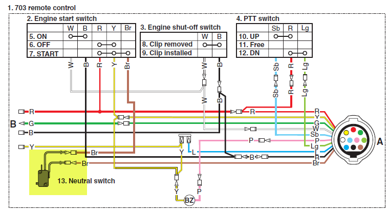

Anyone have a diagram for a 2013 f150ja? Looking for the nuetral safety wires specifically.

The factory service manual has 1, your motor is worth the expense to get it.

OK now I have to ask why that shows W to B connected when in the on position and R to Y in the off position on the start switch

Because the Off and the On are in the wrong position.
Yamaha data is known to be somewhat screwed up.

that would cause someone to really scratch their head if checking the switch if they had no idea what wire colors on Yamaha's were suppose to be

It has. It does.
But remember, Yam data is written for a trained Yam mechanic. This error should be obvious to him.
