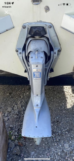

Thank you all for your input! Will reply when not at work. In the meantime, here’s a pic of motor dropped in with 270 hours, ā€œnew legā€ and there’s another dealer refurbished leg with the deal. Asking $12k Canadian (about $4 US!!). Saltwater boat, immaculate inside. Link to ad.

Pics of motor and leg.

Engine looks like a pre 1986 with perimeter valve cover bolts and probably a 2 piece main seal. Quadrajet carb & mechanical fuel pump. It all looks good from the pix

They're saying it's a "new" engine but that must mean rebuilt or remanufactured because of the obvious vintage look of it....pre-1986 that's a LONG time ago.
53,086
I would want to see receipts. Agreed, 1985 or older motor
Dang you guys are good!
