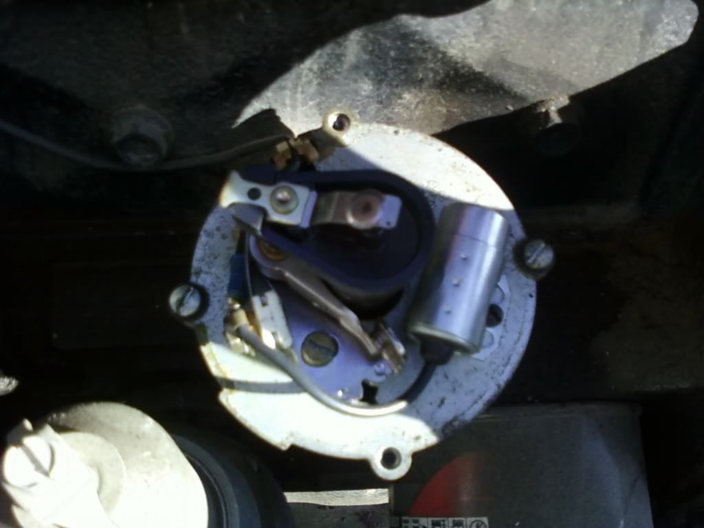

So I did a compression check today and all 4 cylinders were good, all right around 115lbs. I also did a pressure check on the drive and its held the 15lbs for a good 16 hours now, so Id say all the major stuff is good to go. Got a few questions now.
I was gonna rebuild the distributor but it looks like it was just done, take a look at the pic and see what you think (ill link to the big pics so I dont mess up margins)
http://img.photobucket.com/albums/v388/dfalk/Boat/0306101454.jpg

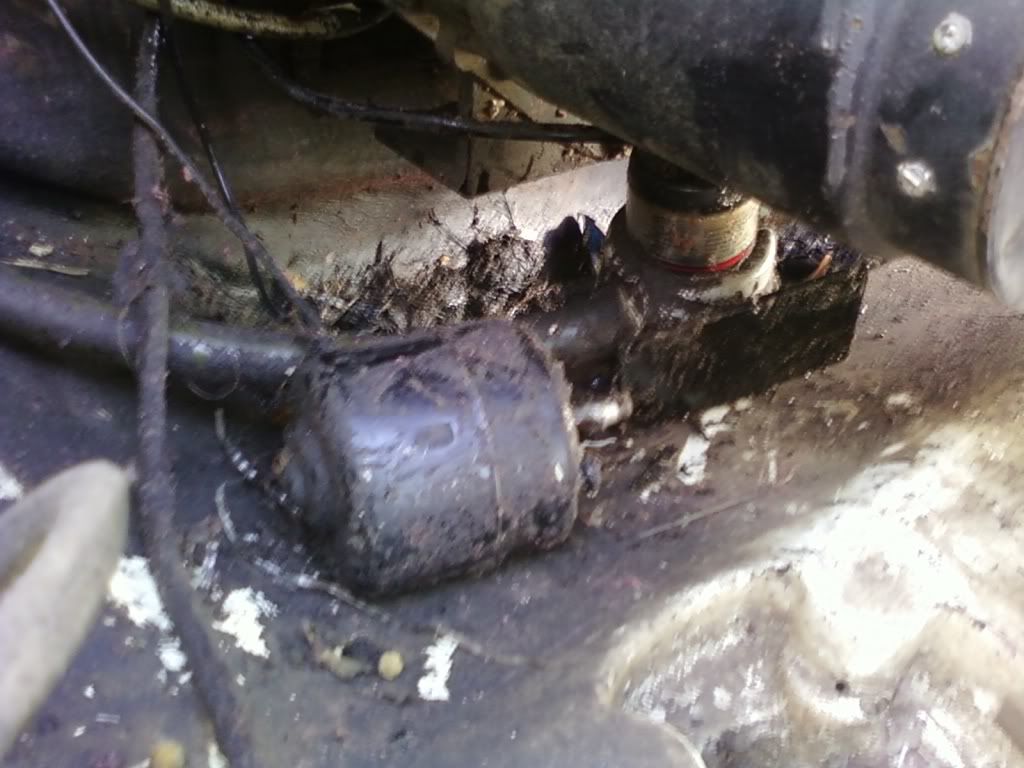

Second I found some "stuff" sitting on the bottom way in the back. One is a bilge pump, and the other is.. well i have no idea. It looks like a motor, and has 2 wires going it. Any ideas? Also how do I test the bilge pump, well I pull the lever on my instrument panel nothing happens, does it have to be submersed in water first?
http://img.photobucket.com/albums/v388/dfalk/Boat/0306101516a.jpg
