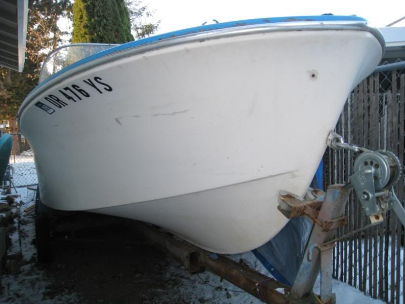

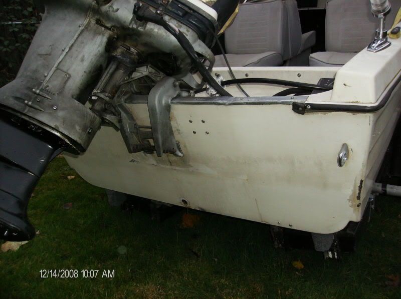

I got the BOAT ! ! ! LOL 2nd Boat in 1 week... the boat looked great, i checked all over for soft spots, and it looks really well done on the inside, his "Buddy" that has lots of boats, did the majority of the work on the inside, and it looks far better then anything i would have done...
The MOTOR I never got to run, as he had 2 other guys that showed up after me, but i threw down the money first, only because i had writen up a pre agreement, that i'm taking it to the local marina 1st thing in the morning, and if the motor has any issues, i can get a full refund, he agree'd and singed... so lets hope everything checks out...
He is only the 2nd owner of the boat, the 1st had it from 1969 till just last year when he got it... He said he was moving, and even when i was looking at, dealing with his new place hes got rented in a few months.
The motor looked clean inside and out, didn't see any discoloration or anything that would set off an alarm, plugs were brand new, wiring looked fine all the way around... Transom felt solid as a rock, but just to make sure, tomorrow i'm gonna have the full thing inspected...

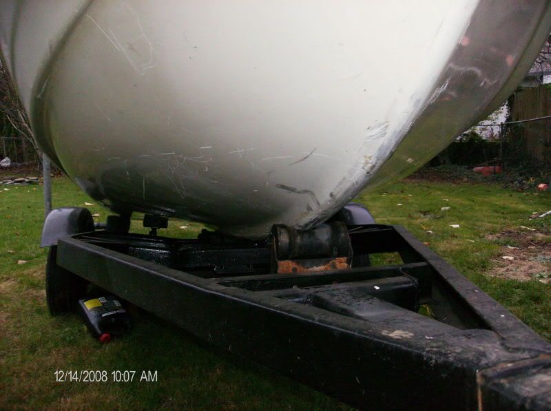

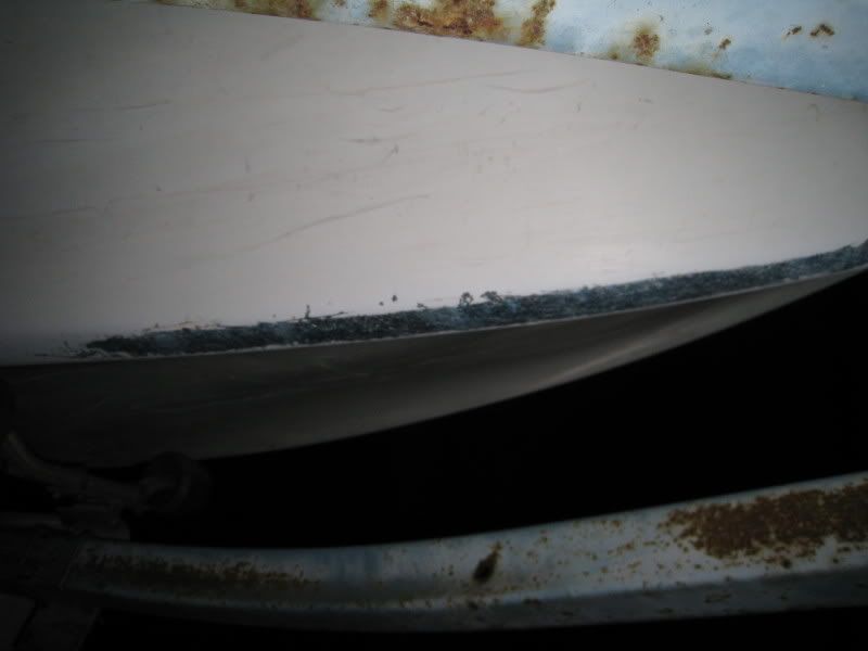

I did noticed on the bottom of the hull, some fiber glass has been rubbed off from grounding the boat on beach and stuff like that... but i saw no rot/holes what so ever, looked 100x better then the last one i got... Here are some shots i took 2night, lots more 2 come tomorrow
-Alex
tashasdaddy
Nov 11, 2005
51,019
Re: Would this be a good 1st boat?
some marine tex, will cover that beach rash right up. if you plan on beaching it, in the future, after the marine tex, put a keel safer on it.

I don't know what marine tex is, but i'm sure i'll soon find out. Would i need to go about the same process as i previously might have (Sand, resin,fiber,resin,paint) To the scrape on the front ? I probably will beach a time or too, so i wanna make sure over winter i get it ready for anything i throw at it during the summer....
The Boats getting a leak-down and full inspection right now... at a quick notice, they noticed the transom was decent, but had alittle move too it... And they are doing a much more indeep check about as we speak, i'll let yall know how it goes... if it doesnt check out, i'll probably just dump it for 1k... the guy had 3 other guys on the way to look at the boat, inside the first 4 hours of the add.
oh, and another thing he noticed is the boats max HP motor was 35, and its got a 50 on it... The boats been like this for 15 years, but should i be concerned now?

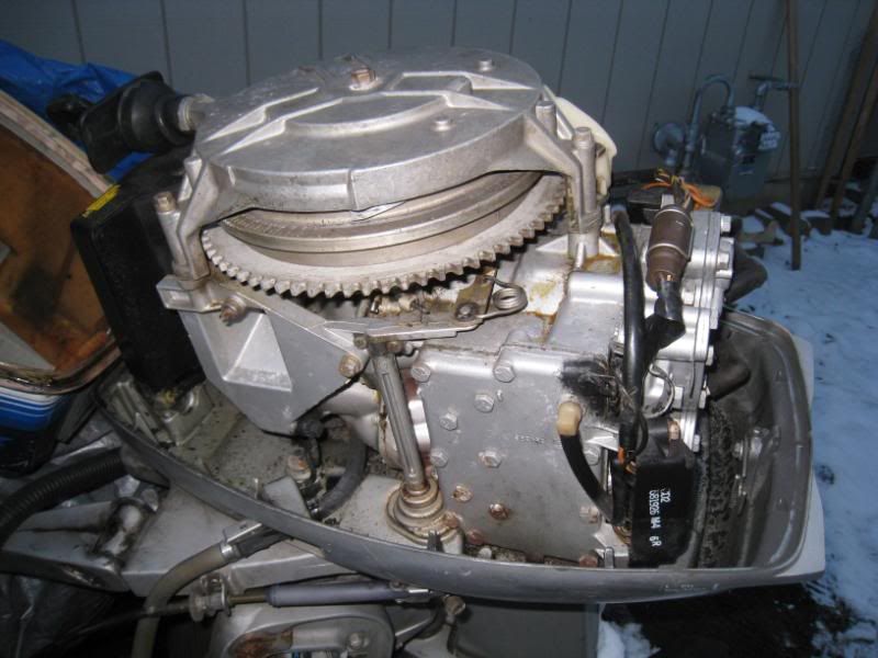

Problem is the Bullet has a small crack on it, from where it hit a rock... and it has caused water in the gears... Not knowing how long it has been like this, and condition of the gears, they recommend i find a new on... If i can find a used one for a fair price, the boat would be worth keeping, if not, ima return it... anyone know where i can find a 1968 murc 50 lower end for few hundred?
Rest of the boat checked out just fine, floor looks great, no other area's of concern.
Here is the bullet damage... the "seller" Keeps saying just epoxy it, and regrease it, and drive it for ever... the shop is saying repalce the whole unit and pump... I found some on ebay for 200-400, that look good... Hard to say how long this one would last... anyway i can find out, mabey take it out on the water and test it ? Or anything i can check w/out tearing it all down.
Prpp also has slight wobble.

oregon......one thing youll find with boats.....is a patch job will only leave you stranded later....if its broke......replace it
eeboater
Jul 19, 2004
2,644
...and in general nothing is ever 'cheap' with a boat :D

I found some lower units that i could use to replace it... but most are upwards of 300 bucks... add that to the cost of the boat, and i think i can find a boat with a much newer motor for the same funds, so unless i hear back from one of the other marina's, this boat is probably going back.
oregonboatnewb
Dec 6, 2008
283
i TOOK THE BOAT BACK, tho the boat was in great shape, that motor lower unit was toast... and when i dropped it off, he was like "oh yeah, forgot to point that out" Then he left real fast, and i had to sit around for 2 hours untill he came back with the cash... good thing tho, he over paid me lol, he gave me back 740, cause he can't count !!! I would have loved the boat for 500, i had found replacement parts for 350.00 shipped, but then gotta put it in, and before i could even do that, i would have had to take that boats lower end off, to see what kind of spline it was...
