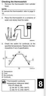

Check first posted pic, shows where the Temp Sensor is located, when a different temp is detected triggers a signal to slow the motor down as not to overheat it, Don't know if that operation could be called a Safe Mode or not, will check with the Service Manual how it works and what it's called for a better tech understanding. Saturday plan going for a 100 Km water raid, hope all goes well, fingers crossed well in advance LOL!!

That motor does not have a limiter or safe mode. The temp sensor when it reaches about 190° turn on the overheat lamp.

I don't think that Yamaha has installed such an extremely primitive system on ithis nice 85 HP Enduro B model which is a Commercial work horse, a loud buzzer would have been much better to hear than to see in plain daylight. Have seen none of the tiller or remote versions to have been factory delivered with such overheat lamp nowhere on the cowling or motor's front and guess what, fishermen don't use central consoles.
Although the Service Manual does mentions at which temp the TS acts doesn't mentions a thing if triggers an overheat lamp or the CDI whatsoever. Could not get a E85B Service Manual to check that out, the only one that could download from the net corresponds to the older 50G, 60F, 70B,75C, 90A versions which has nothing to do with the newer Yam E commercial versions.
Can you explain why after removing the temp sensor and cleaning it along its internal housing the motor is running great again at wot ?

It is a temp sensor. But there is no way it limits anything. It just alarms at best. There are no safe or limiting features on this engine at all. All the best.

OK, do you or FB happen to have at hand the 2 stroke Enduro 85B Service Manual, aside the stated working temp variations in which they act, is there any other indication about what happens when the TS detects a higher temp over its max rated for ? There were no light or audible indications whatsoever when the motor started to misbehave, as a matter of fact the motor kept running well just at a slow rpm when returning to dryland territory.
As a refference, 2 stroke Tohatsu 3 cylinder motors employs Temp Sensors as well, once a higher temp is detected triggers a signal to the CDI to lower the max wot rpm the motor was revving at to a safe min rpm, Why wouldn't a Yam Temp Sensor not behave the same ? Tomarrow will check if the TS connects direct to the CDI box in which case acts as a Rev Limiter ?

Post the engine plate as don't see a 85B engine listed. And yes, I have the 85A manual. The pink wire connects to the CDI and triggers the buzzer or lamp for a overheat.

all of the yams I have played with , had high temp buzzer and RPM reduction to warn the operator there was a problem.
Is this motor remote controlled?
not sure if tiller motors have buzzers or lights if there is no gauges.
when RPM reduction happens or the buzzer or light indicating a problem come on, the operator of the motor is suppose to turn off the motor as soon as they can do that safely to keep from doing major damage to the motor.
it is not OK to keep running the motor
