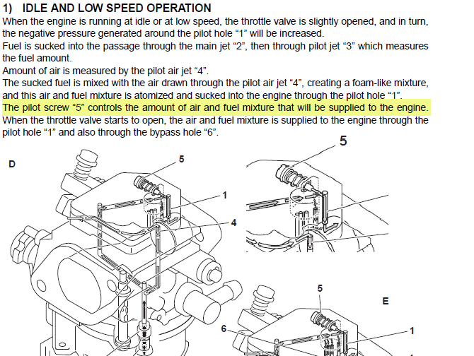

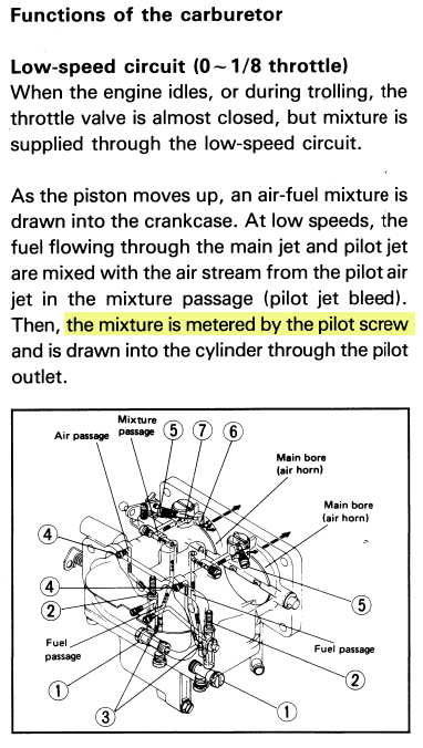

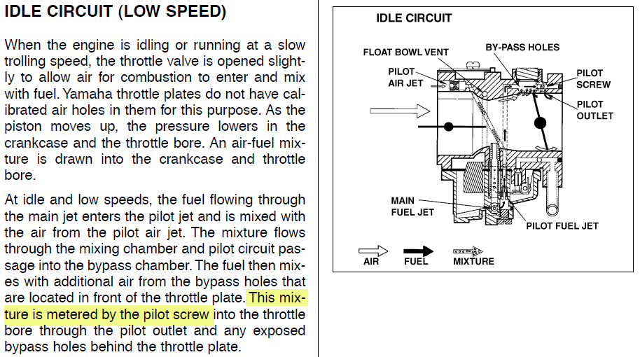

Yamaha's term for an idle mixture jet is "screw, air adjusting".
It does allow some air in as the screw is turned outward. Air that is mixed with gasoline. As the increased air and gasoline mixture gets into the combustion chamber it results in a richer fuel/air mixture.

An adjustable Air Bleed is all it is. It is unlike an Idle Speed Control, though I'm sure it has been misadjusted to achieve that Purpose

seems some people think the Yam130 is special/different from all other motors Yamaha and others make

So Yammie, because they couldn't get a Carb with Air Holes in the Throttle Plate, have created a way of really getting an Engine, especially a Multi Carbed one, difficult to tune.
More Proof that the Proper Service Manual is Needed, and NEEDS to be read, as I have never seen a Carb on a 2 stroke, that had an adjustable Idle Stop. Of course, I have Never seen a Yammie with its Cowl off and Carbs exposed(not many in this Neck of the Great White North). Maybe if I had, I would have been scratching my head, and muttering WTF...
