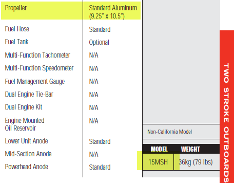

Small Yams do come from the factory with a propeller installed.
This is from Yamaha US data for the last year that the 15MSH was offered.
