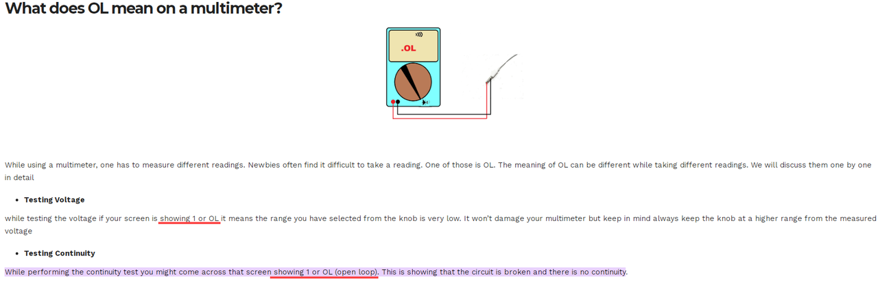

I was reading the 1 on the left that I see with out the probes touching.
as I said before,I have never seem a meter read 1 when set to ohms when reading no continuity.
1 or an OL on the meter, when measuring resistance or continuity, means there is no continuity or the circuit is broken. OL for open loop or open line. Per the inner web.
