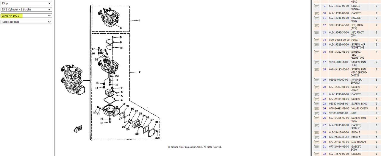

Hello. I have been unable to locate a rebuild kit or part number for the fuel pump on my 1991 Yamaha 25hp 2 stroke. I have called up my local yam dealer and came up short handed. I have seen people on this forum talk about rebuilding or replacing them, but I have had no such luck finding a kit or part number. Anyone happen to know where I can pick one up?

take it apart and just order the parts needed to fix it
gaskets,diaphrams,etc.

Agreed----About the only thing that can go wrong is a ruptured diaphragm or dirt in check valves.----Easy fix in my opinion.

There is no fuel pump "kit".
Part numbers are right where they always are. In the applicable Yamaha parts catalog.
