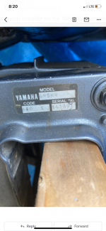

I have a 1993 (according to model number) 2 stroke Yamaha 4hp. I am trying to figure out why it’s not putting water out through the tell tale (I’ve replaced and rechecked the impeller 3 times). After exhausting my options I’ve decided to remove the powerhead to take a closer look at the passageways.
after removing everything and all the bolts holding the powerhead in I still cannot get the powerhead off. I cannot find any diagrams or resources online. This motor seems to have almost 0 community support. Just getting the impeller from the dealership was a mess.
does anyone know how to pull the powerhead? I’ve attached pictures of model/serial numbers and the current state of the outboard.
